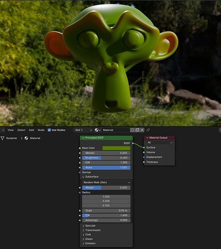

you should get the identical result to the old principled if you mix the subsurface colour with the base colour using a mix node. My understanding was incorrect, I thought having the sss colour mixed with the base colour would make the sss too apparent on areas where there shouldn’t be scattering, but it doesn’t seem to be the case. I’m not sure how the mixed in SSS colour isn’t showing as strongly in areas of little SSS considering it’s mixed with the base, but it seems to work identically.
You might be right.Scattering is depending of light direction and strength of course.Imaging a complete green repile or alien etc is lit from behind.You expect to have red ears from the blood scatter trough the skin.But at the same time the rest of the object in the lower ambient light has almost no scatter at all,is still green.I have to make some tests.
edit,The Random Walk (Skin) mode works very well for a Reptile SSS.
Rendered with Alpha 4.1.0 AgX medium contrast
