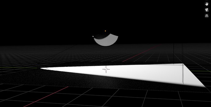

@lukasstockner97 thanks for your BCon presentation!
I used vray in the past and swapped over to Blender + I’m a professional since quite a few years in 3D-automotive now.
Setup:
I just created a plane + a sphere made by turning the metallic value to 1, roughness to 0 and the basecolor to complete white (just for testing purpose)
After this I added a light and increased the brightness all the way up so its a way to bright.
The Metallic Sphere is reflecting the light in a lower brightness level (correctly exposed), i know this is the case in real physics but it looks weird i guess… is this a correct behavior?
Problem: Automotive industry you try to light a car by using lights target on planes to get nice gradient, thats not possible at the moment. There are no values between blown out parts and correct exposure inside of the reflection/specular.
i forgot:
Tested in 3.4.0. Alpha and normal “Principled” not your “Principled v2”
i found out, its a clamp issue
Sorry!
