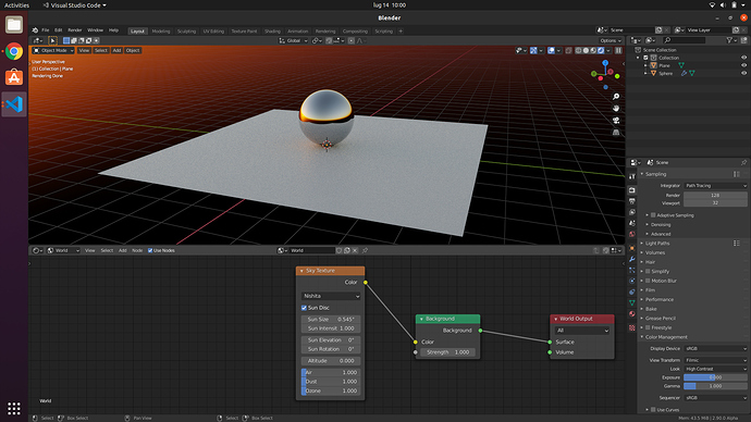

I still have to see @brecht and @StefanW opinions about the Sun Elevation 0 compromise… people seem to find it a good solution but we never talk about it seriously.
I now understand why having a Strength multiplier for the sky texture could be confusing, as it would be on top of the already existing Background strength.
The Sun Elevation 0 sounds like a good compromise to not burn out the render by default.

One extra slider is a big issue if it duplicates functionality. Have you actually taken a look at the screenshot two posts above yours? You see that strength multiplier, don’t you? Why would you want multiplier of a multiplier?

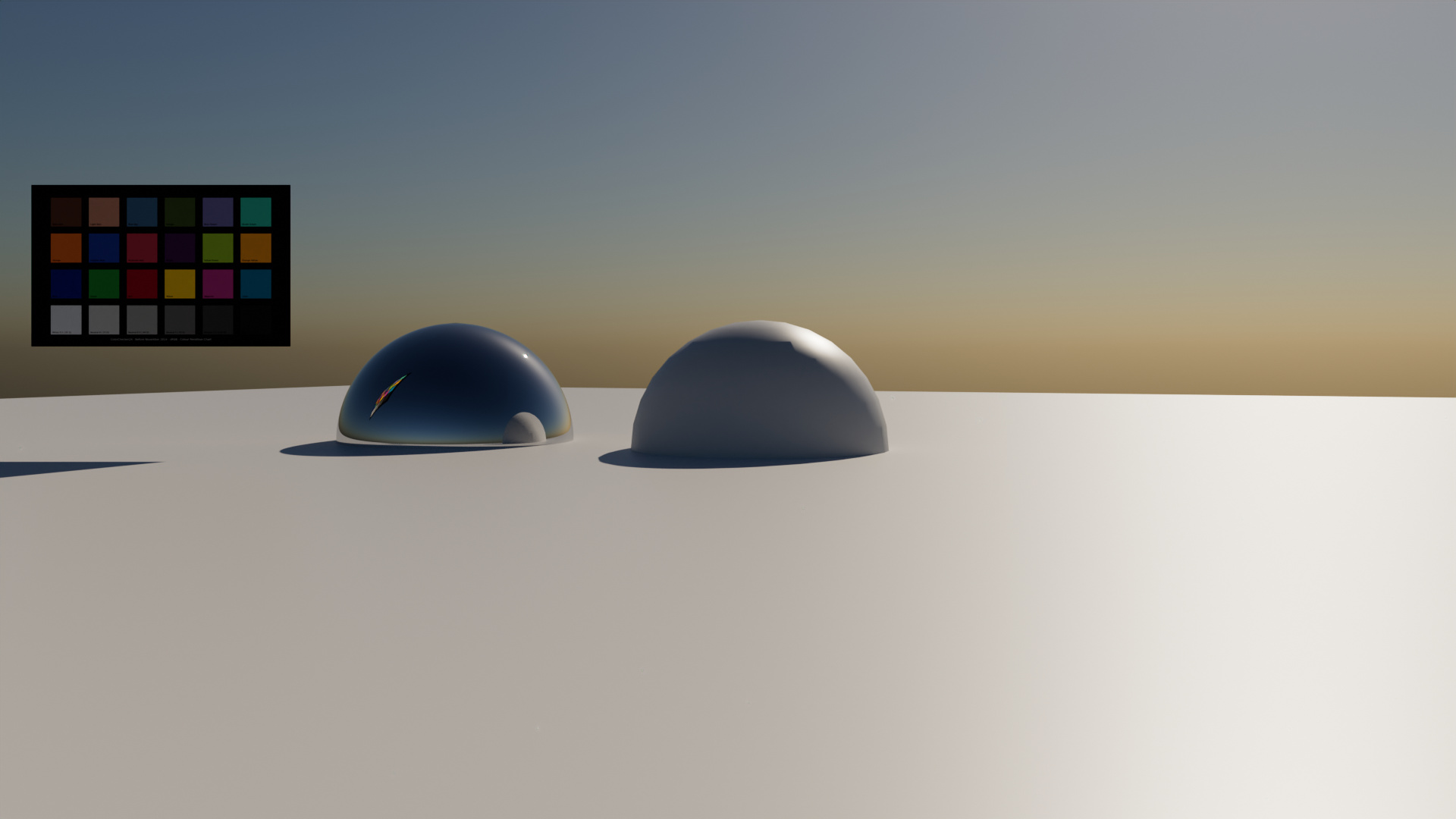

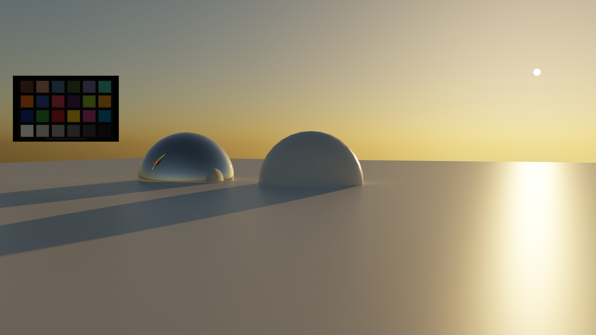

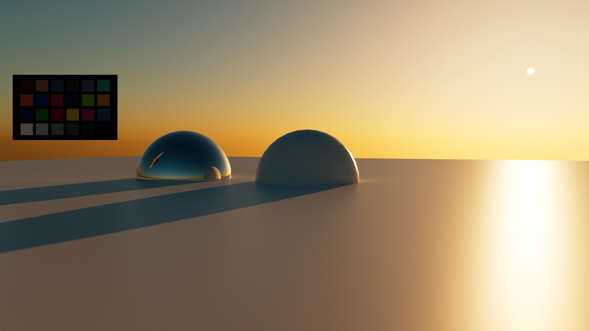

I did some initial renders comparing ACES and Blender Filmic output in preparation for investigating if this is properly color managed. Note that in the below shots, exposure might vary slightly as I didn’t manage to keep those exposures exactly the same.
Also note that this is a build using the patched “physically-correct” version of the sky model.
Filmic:

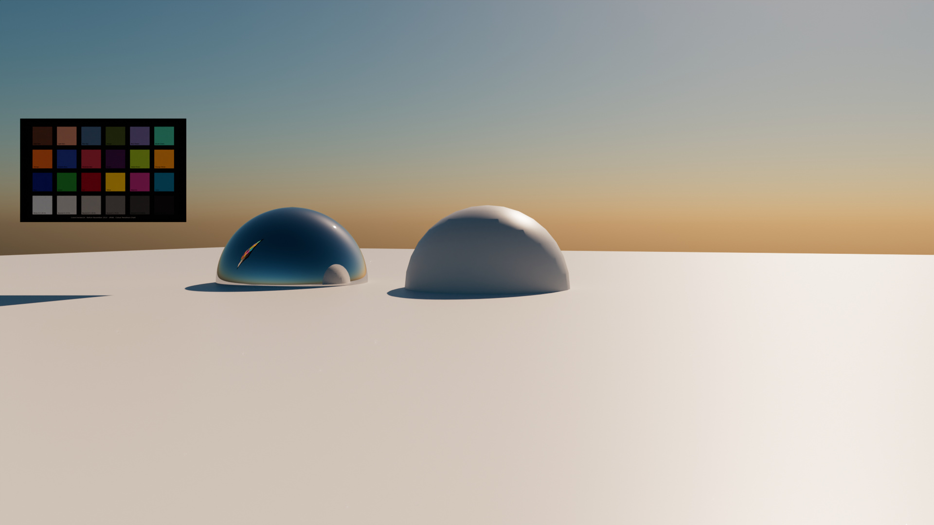

ACES with explicit XYZ D60 space:

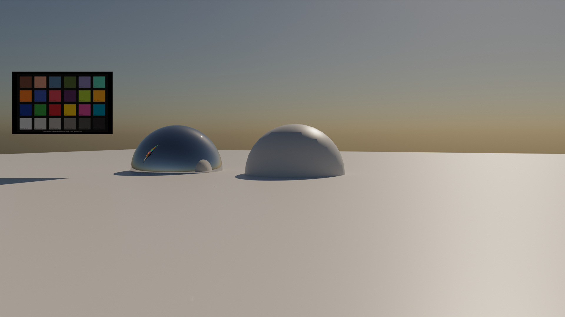

ACES with no explicit XYZ space:
My OCIO profile roles (see here for more information on how Blender interacts with OCIO profiles):
roles:
  color_picking: Output - sRGB
  color_timing: ACES - ACEScc
  compositing_linear: ACES - ACEScg
  compositing_log: Input - ADX - ADX10
  data: Utility - Raw
  default: ACES - ACES2065-1
  matte_paint: Utility - sRGB - Texture
  reference: Utility - Raw
  rendering: ACES - ACEScg
  scene_linear: ACES - ACEScg
  texture_paint: ACES - ACEScc
  XYZ: Utility - XYZ - D60 // disabled in non-explicit XYZ tests
The Macbeth color chart was set as Utility - SRGB - Texture in the ACES version and SRGB in the Filmic version.
Sky settings are the same in both, and because color_picking is set to sRGB, the material albedo should be the same (as in, I am not picking in ACEScg space, but in sRGB space in all versions).
In conclusion, this looks to be properly color managed as long as the user has an explicitly defined XYZ role in their config.ocio that makes sense in the context of their chosen color spaces. In most common OCIO profiles, this XYZ space is not defined and you might have incorrect render results in those cases. The non-explicit XYZ ACES shots appear to be over-saturated, probably because the XYZ - > Scene Linear conversion is doing weird stuff.

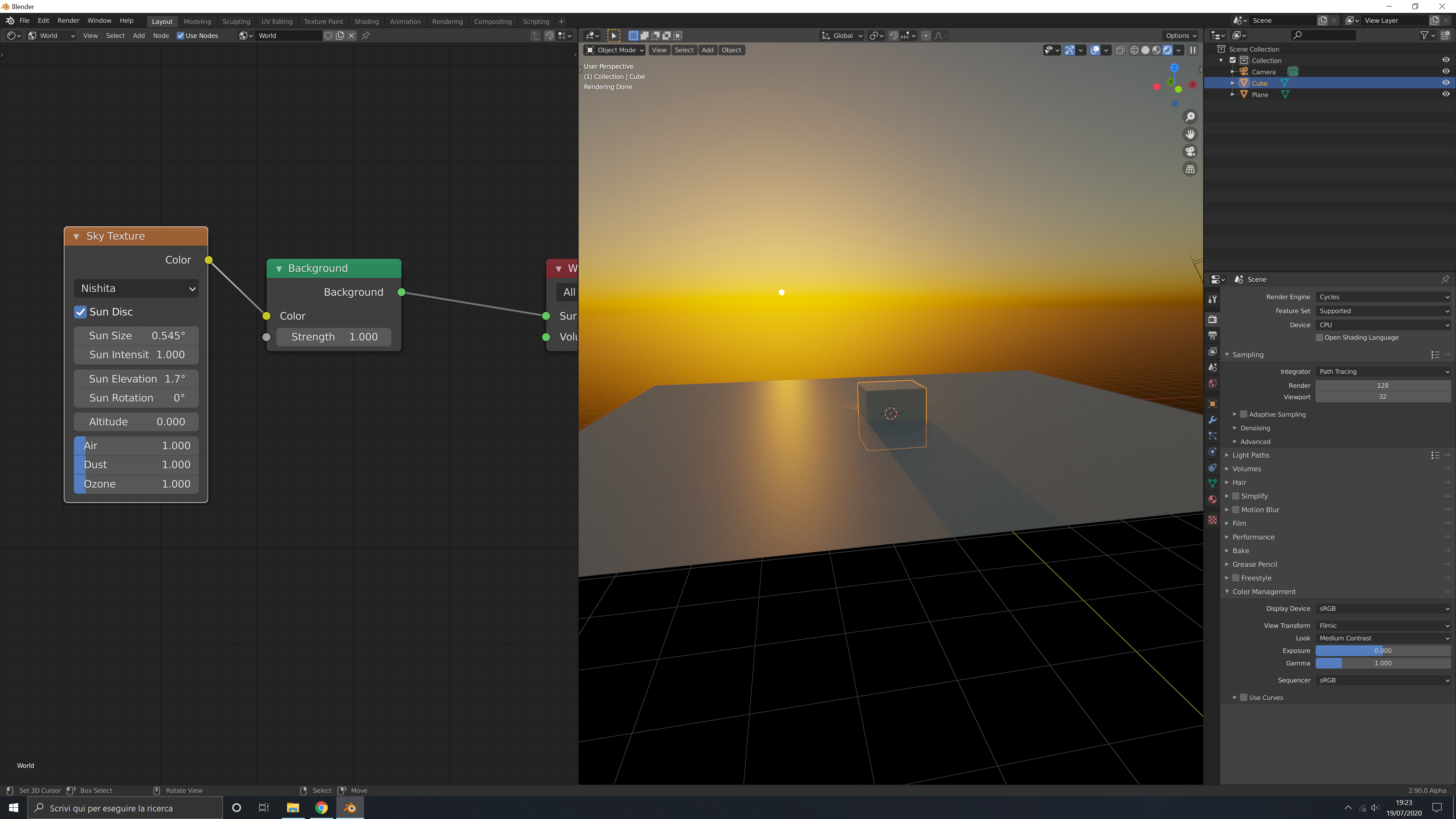

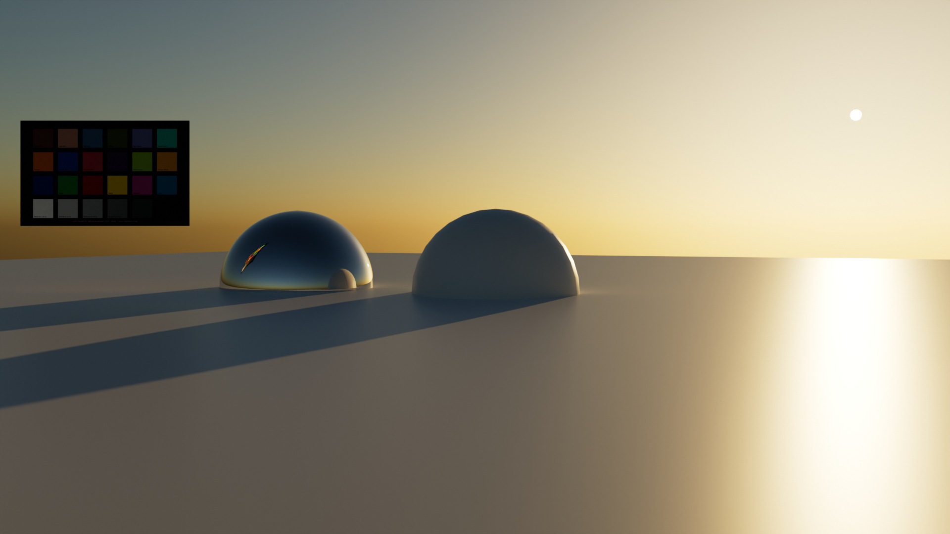

The strange yellowish bar appears at low sun elevations like in the example above… but maybe that’s a model limitation due to single scattering.

Except for the wide gamut examples, which seemingly (?) suggest some rather all-too-sharp ~550nm range, leading to the nasty looking problems?
Can you clarify what wide gamut examples you’re referring to? I just showed an example rendered in ACEScg space, with the proper OCIO configuration, that seems to render just fine.
I believe the XYZ D60 space in the ACES OCIO config is defined for ACES 2065-1, which is AP0 primaries, not AP1. The default rendering space is ACEScg, which is AP1.
Cycles needs an XYZ>AP1 conversion for the sky texture. Troy and I spent some time awhile back trying to figure out what the definition for the XYZ role is supposed to be for ACES in Cycles and we concluded it’s this:
