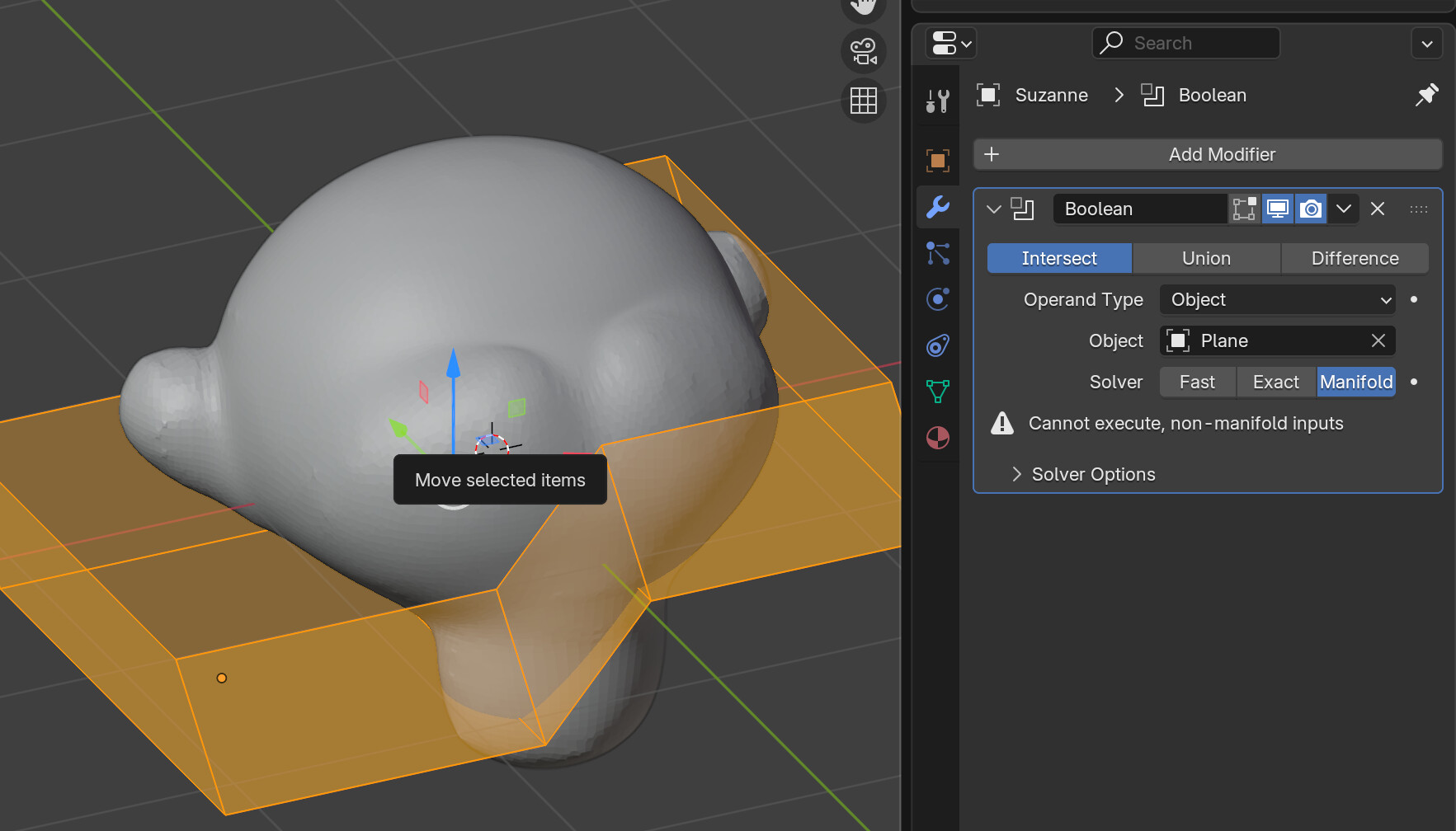

If we had a make manifold node, then do the boolon, then delete new genereated new faces from make manifold, some of these cases could still work in teori.

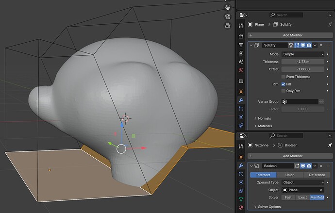

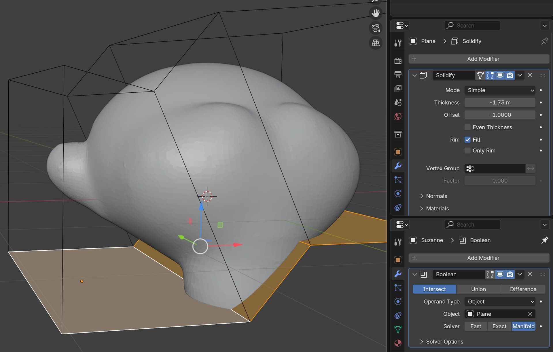

Yes, adding a Solidify Modifier to the operator is enough, the question is, is it worth it to automatically close non-solid shapes?
It is expected and documented that the Manifold Boolean will do nothing if any argument is not manifold. (One exception: argument 2 of a difference can be a simple plane.)

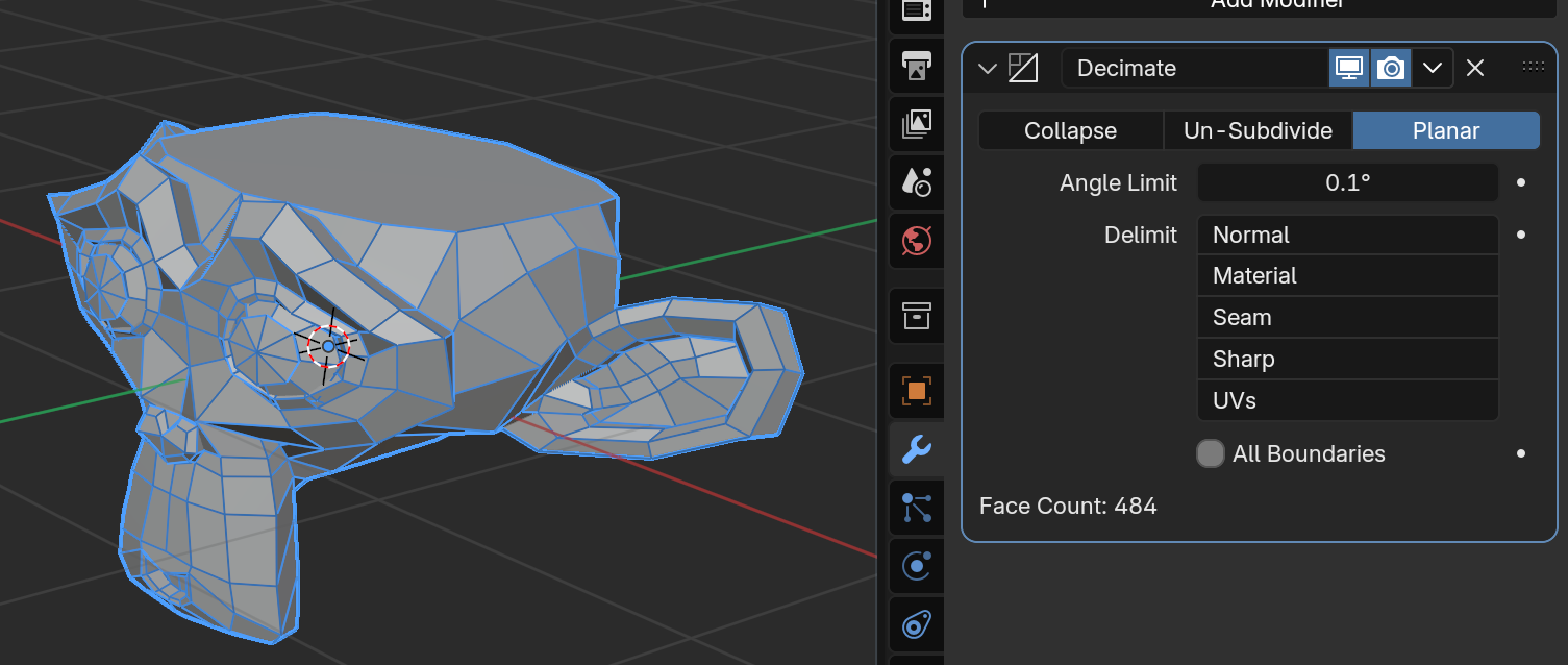

Manifold doesn’t really decimate, but it will “Simplify”, which means merging adjacent coplanar faces. Is that a useful function that isn’t available elsewhere?

“Manifold doesn’t really decimate, but it will “Simplify”, which means merging adjacent coplanar faces. Is that a useful function that isn’t available elsewhere?”
Decimate/Planar/AngleLimit=0.1?

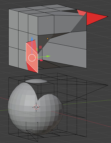

Test A: I’ve found that Manifold preserves the operator’s material, which other methods don’t. Brilliant!
Test B: I have crossed the mesh, to see if it stops working when the normals are inverted, and at least it continues working in the areas that are not inverted, the other methods don’t. Better again.

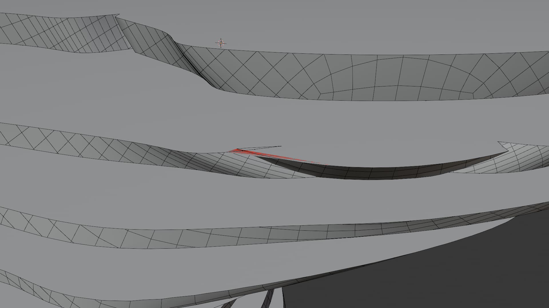

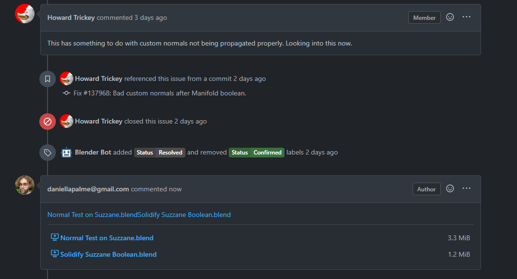

I saw that
was closed, but I can still reproduce it actually.
Please attach the blend file you used to create that image to the original issue and I’ll look at it again. Maybe this is another, but related, problem.
It might be.

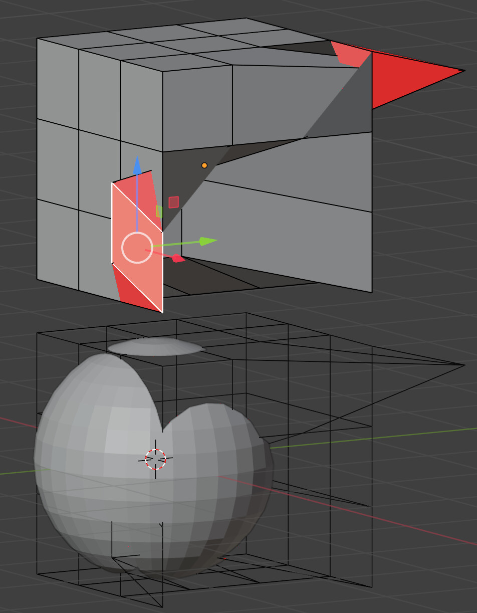

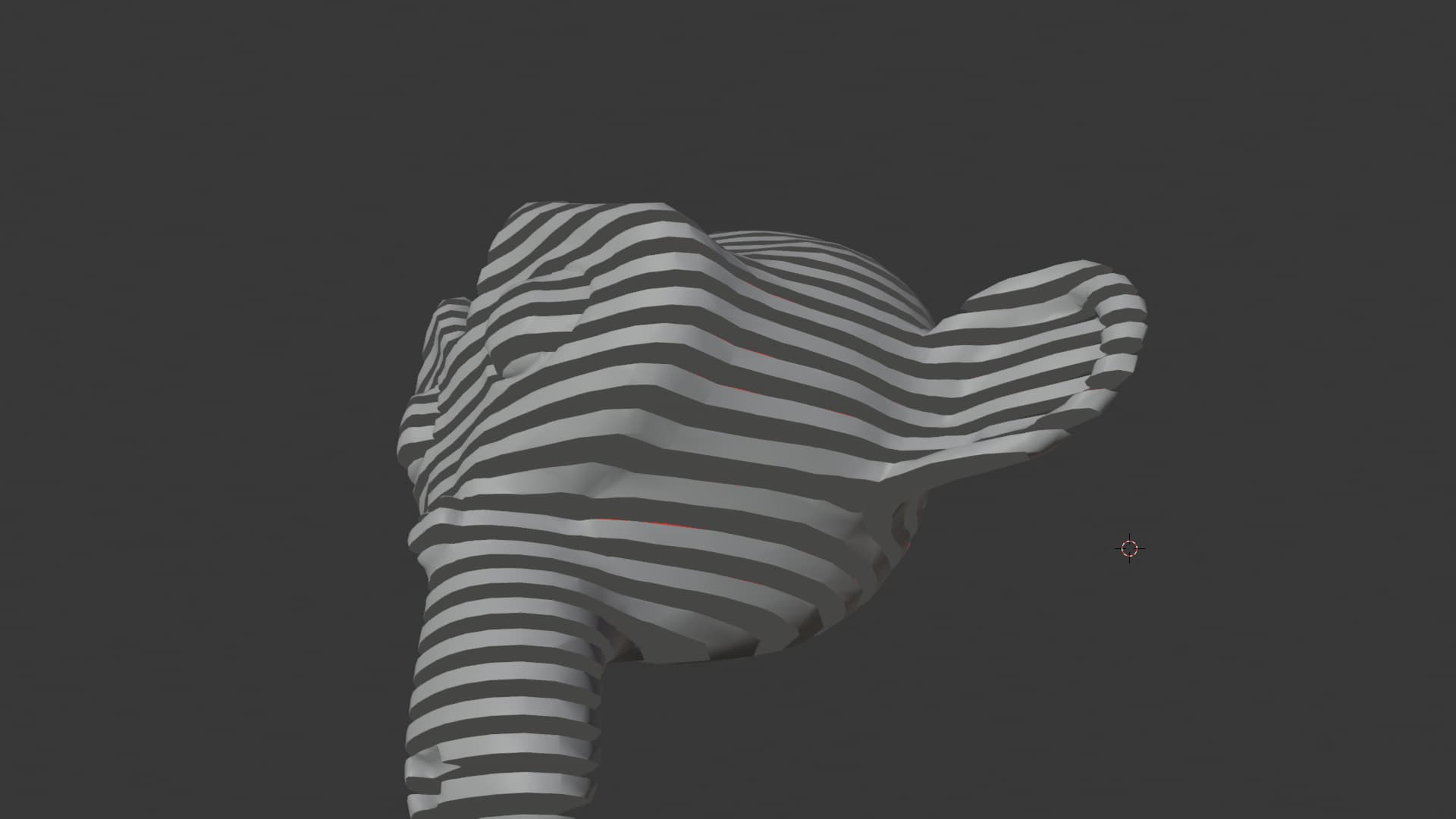

I’ve noticed this solver often creates faces that overlap or span between other faces like so ^
This could be a culprit perhaps? I’m not sure of course, I know nothing of the code.
But in the post just above using Suzzane you can see what I mean.
Nontheless I have attached two files in my original bug report:
