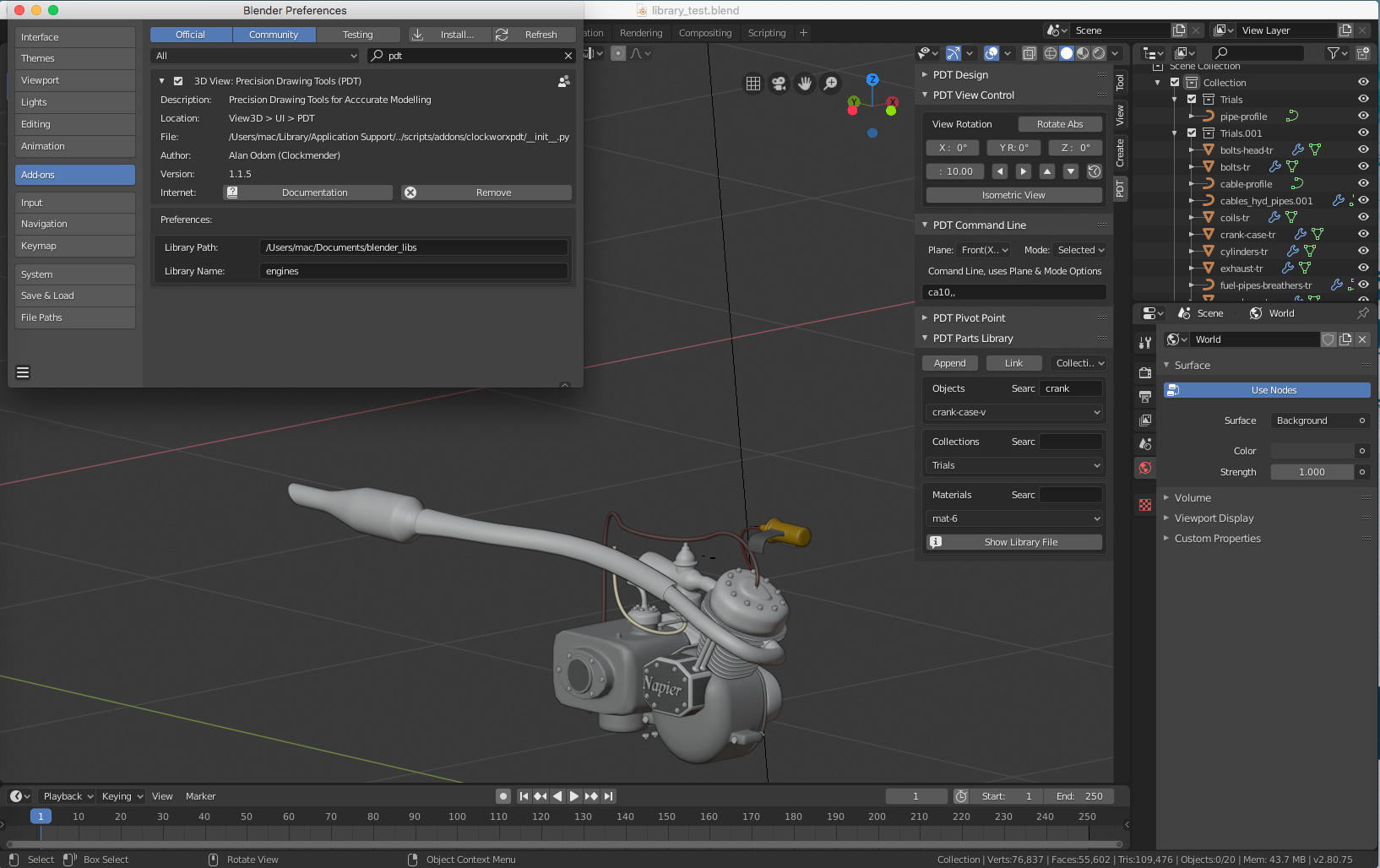

I have started to look at Add-on Preferences and came up with this:
Now you can set the path and library file (you might have lots of library files in one folder) in the Preferences, then work from there. In the image above I have appended a Collection called “Trials” which contains the engine assembly you see in the 3D viewport.
As soon as you press Return, the Parts Library Selectors are updated.
I need to work out how you can invoke the Path selector, that would be a better way to do things, but I haven’t got there yet, so I just type in the path for now.

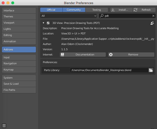

Well that was easy:
pdt_library_path : StringProperty(
        name="Parts Library", default="", description="Parts Library File",
         maxlen=1024, subtype='FILE_PATH'
:grin:

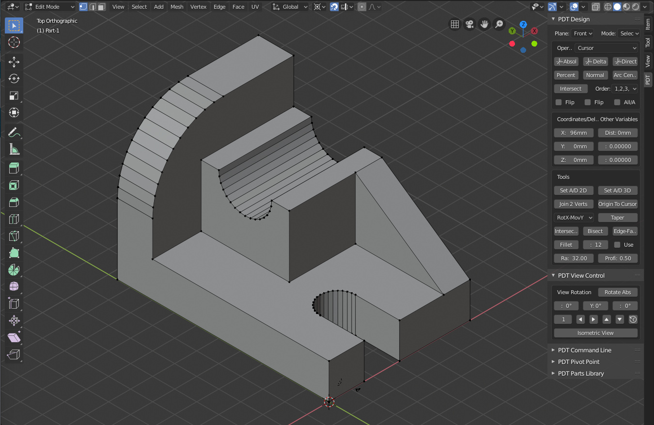

OK, so just under 5 mins 30 seconds with PDT, but then I wrote it, so I should be fast with it, that time included finding all the dimensions from the youtube vid, shown in Isometric View:
Nice mech. topology, yum, yum :yum::yum:
Seriously, CAD techniques produce faster results and better topology for precision work, but you can’t use Sub-Div modifiers, but then you wouldn’t want to… I did not start with a cube, I started with a single vertex BTW.
Cheers, Clock. :grin:
