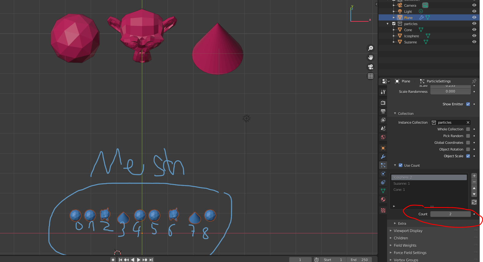

Here is an image of a collection (red) consisting of an icosphere, a monkey and a cone.
Below is a mesh that consists of only vertices. Their index numbers go from 0 to 8.
This mesh has a particle system using the red collection as as render source and is set to “use count”.
The list circled in red indicats the order in which the objects are distributed on the mesh and the number next to the name indicates how many objects of this type are put on to a vertex until the next object is used.
Icosphere: 1, Suzanne: 1, Cone:1 means that one Icosphere is placed on the first vertex, then one Monkey is put on the next vertex and then 1 Cone is placed on the next vertex. Then it starts all over and one Icosphere is placed on the next vertex and so on as seen in the following image:
In the next image I turned up the count of the Icosphere from 1 to 2 and now the order is no longer
icosphere
Monkey
Cone
but
Icosphere
Icoshpere
Monkey
Cone

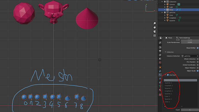

Now in the next image I gave every single particle its own entry in the list. The Order is now:
Icosphere
Monkey
Icosphere
Monkey
Icosphere
Monkey
Cone
Monkey
Cone
This is how you can control every single particle.
I once wrote a script to automate the distribution but it was for 2.79 and does not work anymore. However, even if you know python there it is very troublesome to set up because you can not simply feed it a list but you have to let python highlight the list item you want to duplicate then duplicate it and then move it with to the correct place with the arrow operators. It is absurd but doable. It is also slow for larger particle systems.
If you find a good way to automate this with Python I would be very interested to know how to do this.
