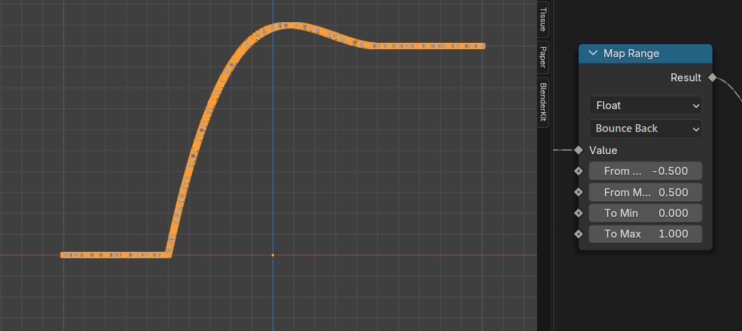

an example of what can be done right now just adding more functions to map range
I’m already successful at adding to map range, and as a novice, it was striking how many files I had to change to do it, though from what I understand half was the UI element.

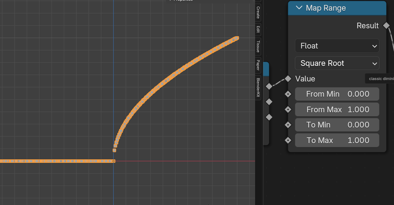

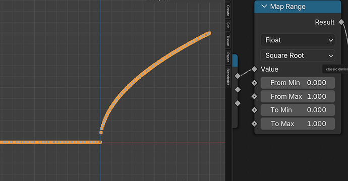

I thought I would just add the basic interpolations found elsewhere in blender- sinusoidal, quadratic, circular… However, I noticed many of them, such as square root, have interesting math that go beyond the 0-1 range it’s limited to when naively added to map range,
and it would be useful to have a checkbox to extrapolate it, or one where you can smoothly adjust the functions’ values for interpolation using proper inputs, instead of just having arbitrary “smooth”, “smoother” interpolation. There’s nowhere else in all of blender that uses “smoother interpolation”, either (which made it easy to search where I needed to add to, but still).

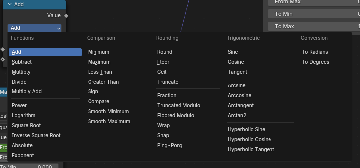

and, once again, I’m even more conflicted, because I don’t want to bloat the node, or its drop-down… but then the math node is sitting there like
with most of the functions I just mentioned, and more- the very ones I use to do this without a dedicated node- which again begs the question of whether or not this is even remotely necessary!..
