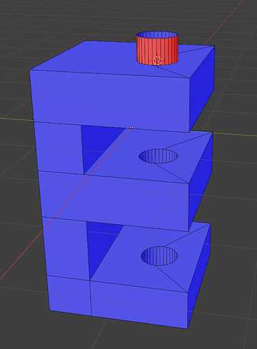

One more thing - not exactly problem with the extrude boolean but weird still.
Two columns, boolean extrude without Remove coplanar faces.
So far so good. But when I try to create a loop cut it skips two faces although all faces are quads (I’ve checked the geometry by moving vertices and also by select faces by sides=4).
