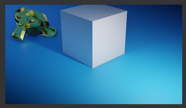

Here are two interesting synthetic effects that I often use: 1. Simple synthesizer scene fog
2. Take pixelation as an example. Only perform the compositing effect on a specified object and its mask

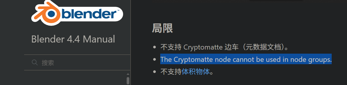

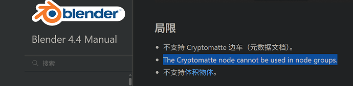

So far, does the fact that Cryptomatte masks are not supported for use in node groups to some extent prevent synthesizer node assets from having the ability to only take effect on the specified objects in the picture?
Will Cryptomatte nodes be allowed to be used within node groups in the future? Or is it that assets are not required to be in units of node groups, and multiple nodes can be directly loaded as assets?
2. From the two cases I provided, it can be seen that some compositing effects rely on the renderer to enable some channels that are not enabled by default, such as Cryptomatte. Can assets that rely on channels directly enable the corresponding channels when in use?

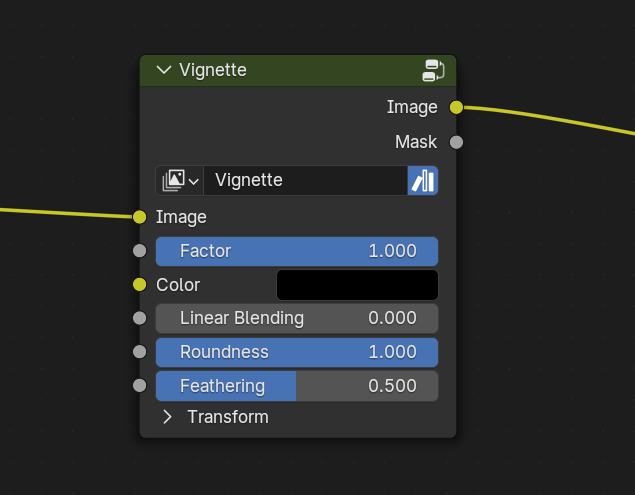

I reworked my vignette to use the new Blender 4.5 features and made it a bit smarter.
Download (requires 4.5 alpha)

Thanks. The synthetic fog effect is interesting :slight_smile:
I’m not sure per object pixelation would be a good asset. In this case I think it’s better to have a pixelate node/asset and rely on cryptomatte as the “object selection” node.
This is one of the main reasons why Render Layers and Cryptomatte nodes are not allowed to be within node groups. We have plans to support that in the short term, and we are also considering supporting Bundles to simplify links. Meanwhile, assets should treat passes as separate inputs.

Thanks, this looks quite similar to what we have in mind already.
I noticed that you could create non-elliptical masks, and I was wondering if this is intentional because I’m not sure about its use case.

Yesterday I downloaded the asset and tried it but I have some doubts.
The first doubt, as has already been written, is the roundness feature that generates sharp and discontinuous shapes because a lens distortion is used to generate the vignette mask. The only use case that comes to mind is simulating obstacles in front of the lens.

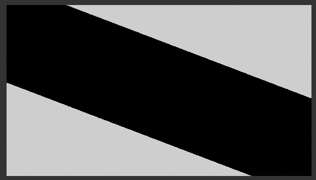

Yes! This is very handy. Maybe not so much for making rectangles within the frame but for doing things with straight lines like this:
Fixed in this improved version: https://www.dropbox.com/scl/fi/fze160pr0rhahcnpt06h4/Vignette_3.blend?rlkey=6fj6c06q8gspk0ma2yyk37qf5&dl=0
Now that we have access to the image info we can finally generate a superellipse.
