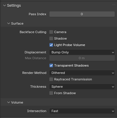

I am confused here, because I really can’t find the answer. What is animated by the Material data-block? Everything I can keyframe on a material seems to be animated by the Shader Node Tree data-block.
Anything that’s not in the shader tree, but still configured on a material. For example these settings here:

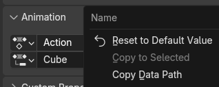

Cannot copy action/slot to selected objects.
