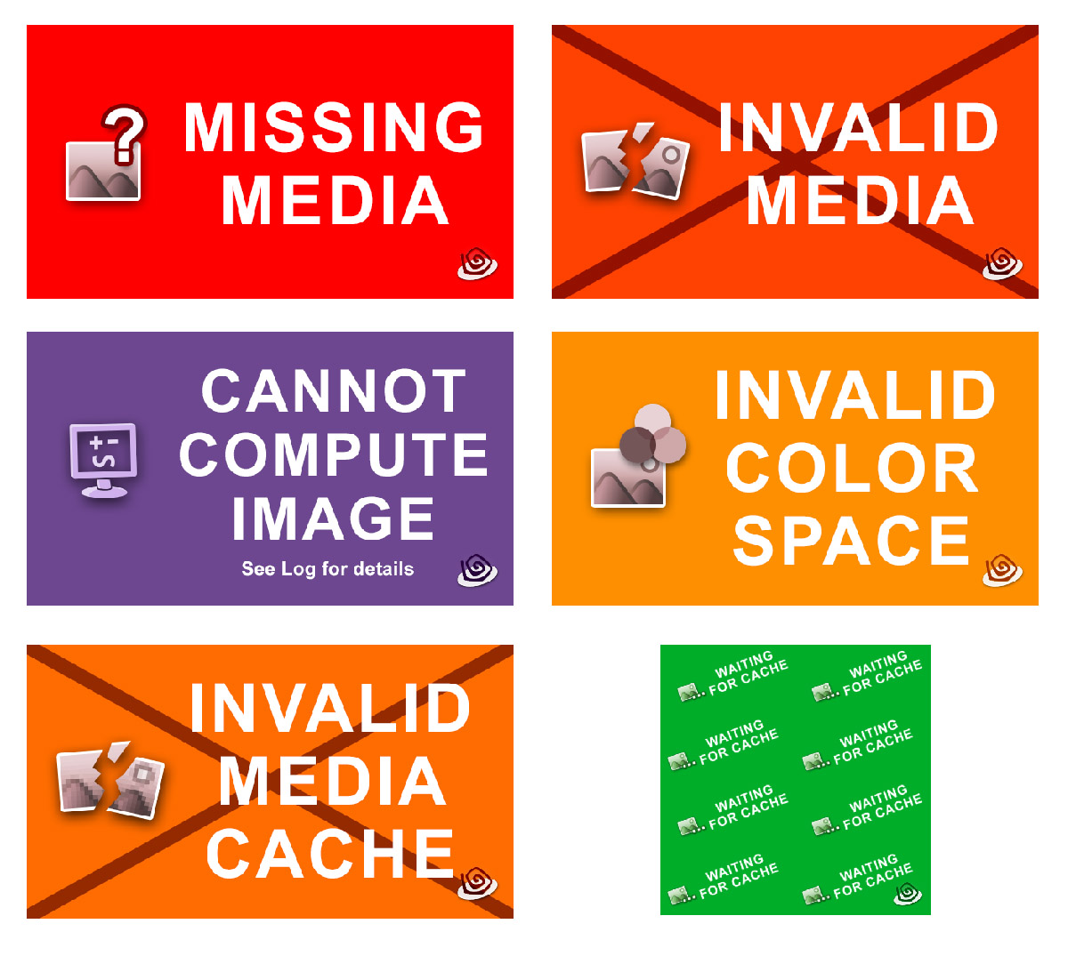

So what I suggest here is to introduce a set of built-in images clearly mentionning the cause of the issue to be used instead of the pink rectangle. Hence when a proxy is missing we could see on the image a text saying “Missing proxy”. When a file is not found, “Missing Media”. When the file is fond but it cannot be read, “Invalid media”… And so on.
We implemented that in the in-house software we used before switching to Blender and it provided pretty good results. Here are the images we had:
I think this is a really good idea. Except the Ubisoft Animation Studio logo that’s sneakily put in the corner
Implementation wise it can be more tricky, though, as it probably requires passing more information about the nature of a failure to different parts of the code (instead of just returning NULL). Still I think it’s worth the effort, as it’ll certainly improve user experience.
Currently if proxy is not found, we do “fallback” full resolution render, which may or may not be desirable depending on circumstances. Refusing to provide output or substituting it with info graphics is sensible, but in case of proxies a little bit aggresive I would say. We could throw warning message instead with explanation of situation and how to resolve it.
Similar problem is “fix” for case where we stopped supporting recursive scene rendering from VSE. Instead of producing pink output, that may look like glitch I insisted on producing rather blank output with error message being shown. Here the “invalid media” image would be more appropriate.
@sybren Well, it’s not the UAS logo (we currently don’t have our own one), it is the logo of our previous 2D/3D tool. But you are right, I should have removed it or put a Blender logo instead (which at the end is what I would recommend instead of no logo at all since thanks to it the user clearly understand that the shown image is coming from the application).

Warning messages are great and helpful. In some cases though having also - or even only - an error image with the right information on it has some advantages. Whereas the warning message is sent once (or at least not often in order not to be intrusive) the error images can stay longuer, they do not prevent the user to work in the scene and they stay as a reminder. For example when a media is missing because the file is used offline it can be ok to work with the file and seing the Media Not Found image instead of the actual clip or texture, and everything will be fine again when the user goes online again.
