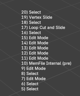

Well, that was much easier!! Thanks for this update!
In fact it was so easy I’m almost not believing I did it correctly, but it’s working. :slight_smile:
wm = bpy.context.window_manager
undo_stack = getattr(wm, 'undo_stack', None)
So far the only thing unexpected is that I sometimes (rarely) still see these “MemInternal (pre)” (or something like this) entries, which I don’t think appear in the regular Undo/Redo MenuBar menu. I’m not even sure what causes those to appear, I have to really mess around to get it to show up. But I think filtering those out to make it match the entries in the Undo History should not be an issue.
So yeah, this is cool! I’m going to see what I can do to polish this thing up and then maybe work on a project or two to give it a better test. I can’t remember what issues I was having with the old method (it has been a while), so hopefully this will be much more reliable. It’s certainly nicer code on the Add-On side.

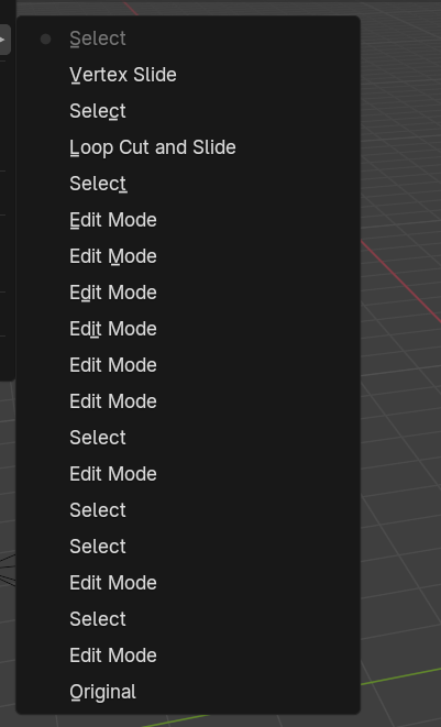

Edit - there it is:
Strange, I guess I just don’t render it.
So, the MemFile Internal steps are interim undo steps that are marked as “Skip” internally because they aren’t an undo state you can actually stop at, they are part of another. I’ll expose the skip parameter (so you can not expose them to the user if you want, just like the built-in menu), and then I think I’m done, actually.
